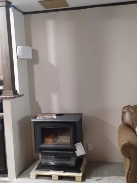

Here is a pic of the space with measurements. The cardboard on the ceiling is template for the ceiling box location between rafters. The wood stove in the pic will soon be taken back for a refund and hopefully replaced with a Vista :)
[Hearth.com] Vista Classic, is it the one?
Clearances are:
95" from top of carpet to ceiling
55.5" from wing wall (inside corner) to couch arm
27.5" wing wall (inside corner to linoleum)

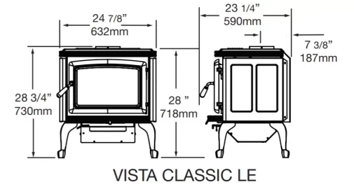

The bar top under the column hangs over the drywall by 2". The manual says that with double wall stove pipe (Ill use a DuraVent DVL slip pipe, collar to ceiling box) the clearance needs to be 8" so I would have the Vista Classic no closer the 10" to the wing wall. 8" from the rear of the stove to the drywall with the stove measuring 23 1/4" would put it about 31 1/4" making it stick out past the wing wall about 4 1/4".

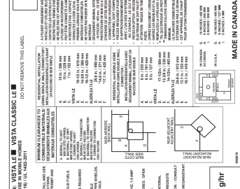

If i do wall protection how much can I reduce the clearance? This what the Vista manual says ...
"Clearances may be reduced with various heat shielding/insulating materials. Consult CSA B365 or NFPA 211 and local fire codes and authorities for approval. For close clearances, use a listed double-wall connector"

Worst case I can live with a 4" protrusion into a 7' archway to keep the drywall safe. Ill be building a hearth out of 2x4's topped with 20x20 hearth stone and plan on making the front section detachable so I can remove it from the walkway in the off months.
What are your thoughts? Do you think the Vista Classic will work?
Thank you for any help~
I've been looking and trying to learn about clearances. I found that in the NFPA 211 , Table 12.6.2.1 Reduction of Appliance Clearance with Specified Forms of Protection part (d) it says up to a 66% Maximum Allowable Reduction in Clearance as a wall protector with a 3½ in. (90 mm) thick masonry wall with ventilated air space. I had planned on using manufactured stone on durarock board with the 1" air space behind as well as leaving 1" at the bottom and top. So what Im getting out of this is that 66% of 8 is 5.28. So does that mean that I can subtract the 5.28 from 8 and need only a 2 3/4 distance from the combustible? Seems odd to slam the stove right up against the rock. I know the stove pipe has its own requirements as well. The rock will go all the way up the wall so would the reduction apply to the pipe as well? im not too worried about space to clean or service. Im more concerned about fitting it in the space. If I can gain couple extra inches in this fight Id be happy. Please let me know if im looking and going about this the right way. thank you~
one more thought ... if im thinking about this math correctly I may be able to just keep the stove I have. Im just getting more confused. hopefully someone will chime in ...
As noted in the other thread, 12" is the minimum distance permitted unless otherwise documented in the stove manual. For the Vista, the tested clearance minimum is 8". It's a good stove and fit for this setting. If you get PE's ok to reduce the clearances in writing, then it should be ok.
Remember, the clearances are to the nearest combustible which is the sheetrock and studs in this case, not to the face of the heat shield.
