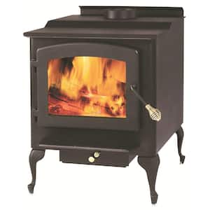

Dont waste your money and just get you one of these new at Home Depot nearest you in Virginia.
You will pay for it the first year in heat savings if you cut your own wood.
(broken link removed to http://www.homedepot.com/h_d1/N-5yc1v/R-100291302/h_d2/ProductDisplay?catalogId=10053&langId=-1&keyword=wood+stove&storeId=10051#.UNDRx-TaJZI)
