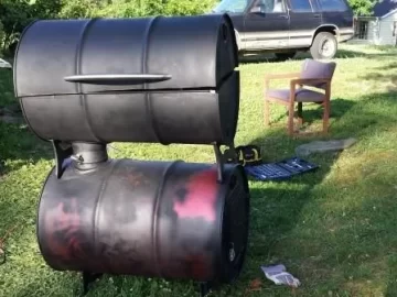

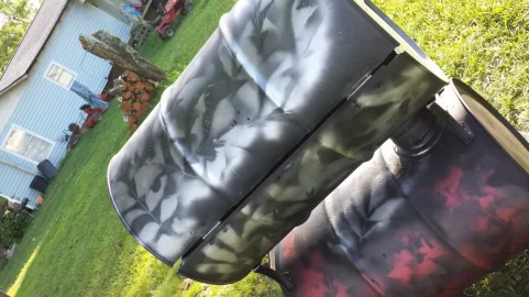

Hey SCF funny to see you outside the pellethead forum. I built a Double barrel kit just this year but I fileted the top barrel hinged it and use it as a smoke. regarding the bottom (fire) barrel what I did is line it with sand then lay the 9.5 x 4.5 firebrick longway across. Maybe overkill but the sand insulates the fire and helps set the brick (it took 7 really nice). The FB made it easier to scoop out the ash. Just my 2 cents. Good point above though about quaility of barrels, but I know you well enough to know that has crossed your mind already. Good luck I have some pics :)

Owen, life is more than a pellet/corn space heater...... I post on the chainsaw forum too. I may add a loop of pipe inside the upper barrel and add it to my PEX loop in the shop floor. Far as barrels go, we have good ones at the shop all the time, fixed and removeable head. I get a lot of wood here that I give away, might as well roast it.
I take it you used the Vogelzang stuff???

LOL No I used the USSC one. For the price I got it at it was just perfect ($0). I worked here when VG was a competitor so I favor USSC even though VG is owned by us. I've heard great thing about Sotz too...I think my barrels won't outlast the cast Iron parts, it is an outdoor smoker. I did use the deluxe door...better air inlets.

This old sotz, had a lot of years of service before being turned into a smoker ( 30 plus) .

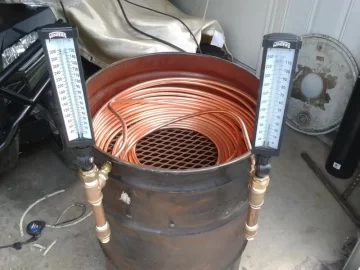

Remember this guys set up to heat a pool....wouldn't recommend it.

No large coil in the upper drum, just a simple. single U with a feedwater pump to push the cryotek to the existing system. Sounds to me like if you seal the Vogelzang kit properly, it works as well as the defunct Sotz. I suspect the devil is in the details.
I'll come up with something before next winter and I'm sure it will be complete with a tempering circuit for the existing PEX system and maybe a ambient HX or 2 in the circuit as well.
