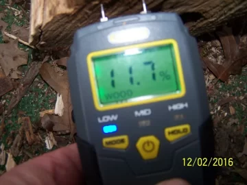

None of my wood is over 16% on the face. I have tried the controls in every position there is. I have taken my craftsman 5hp shop vac and went over every air intake and outlet it has. I once got out a bunch of sut and some construction stuff and thought now I have it but it still does the same thing. All my wood is cut, split and stacked while green and let season while cover on the top but the sides open.

Regarding the moisture meter readings you're not doing it right. Reading should be taken on room temperature splits that have been freshly split again just prior to reading and not from the ends.
Cold wood, end readings and readings taken from the face but not freshly split will all cause false low readings on the meter. You want to get a reading of the "heart" of the split or round not one from the exposed exterior which will read low after only a couple days drying time.

Need to find out if the wood is wet or not. Split a aplit off the pile you've been burning, take it in and let it warm up, then use the meter on the fresh split.

I hate it when people jump straight to 'wet wood', but uh.... test the wood at room temp on a fresh split. :)
