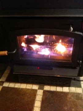

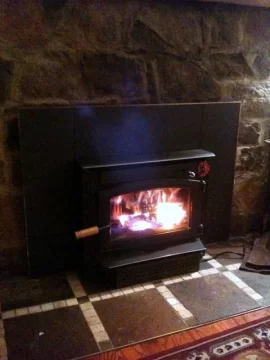

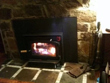

Hello all,
Been around here reading and all for about a month and decided to register and post. I just recently purchased my first wood stove insert a couple weeks ago and installed it last week. I figured I would share some pics of it and my opinion of it. I couldn't afford a nice Jotul or Hearthstone Clydesdale like I wanted. Well I guess I COULD have afforded it but just couldn't part with 4.5k - 5k for the stove, pipe and installation. I came across this Vogelzang The Colonial insert on Northern tool for $899 and decided it would be my first baby (not counting my son..err or my wife). I then purchased an Everguard SS for 700 (including some insulation, rain cap etc). A buddy and me did the installation ourselves and the entire project cost about $1,800.
The firebox for the Colonial is small. I measured about 1.78 cubic feet versus the 1.28 something the manufacturer stated it is. Still it is small. However I do feel that I am getting plenty of heat from it for the little amount of wood I actually use. I have a 1,800 square foot house and it keep the tempts well into the 70s through most parts with the exception of the far off bedroom that sits around 69-70 on a 30 something night. My house is very boxy so I might have to get a tad creative about getting the heat spread around. The 6-8 hour burns times are easy enough to achieve and I have found myself with firestarting strength coals 16-24 hours after last full load. Despite the " you can always have a small fire in a big firebox but not a big fire in a small box " mentality, I have found the small firebox to actually output similar heat to my friends Clydesdale and use a lot less wood to do so. Smaller firebox for me means smaller area for the warm air to escape versus a large firebox and trying to do a smaller fire. Sure I would take a larger firebox if I could, but it is nice to conserve. :)
So far the only negative I have found with this unit is the blower. It is not regulated by heat and is poorly designed. It does attempt to pull air from a similar area it is trying to push. the unit attaches to the stove just below the ash guard and I have found loosening the screws so that it is no longer flush with the body of the insert solves the design flaw.
All in all it has been a great value for my money. I guess time will tell if the parts hold up to be durable or not. Everything looks quite easy to replace. Being new to wood stoves, I am still learning and all so I hope she hangs tough for me. :)

Thanks for the post and pics. She looks like she's burning well.

Nice looking fire you've got going! Keep us posted on how the stove performs.. Looks nice from the pics..
