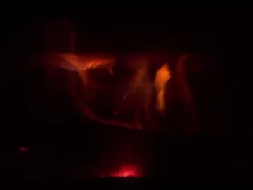

Just some pics of the vogelzang burning on and one of the little bub holdin it down while John takes a peak up the chimney, little turd
Man that pic of your baby is classic. I would frame that pic. Looks like he is helping you there.
Is the pic of the flames towards the end of your burn cycle or fresh reload? Looks like the secondaries are trying to get started there. If this is not long after a reload you can try adjusting the air to about 1/4 an inch open or you can cheat and open the door for about 30 second and then close the door with the air closed down all the way. I get some nice jets with my cheat method. I learned that from having to reposition some wood that had fallen on the glass when I was getting lazy secondaries.
man i cant remember if those were at the end or what, but im wantin to say they were right after i shut the air off, the pics look a little weaker than what was really goin on lol i bought wood from a gas station cause someone on here thought my wood i couldnt get to burn might have been too wet still, i still ended up with dirty glass around the outside of the window, this thing has been kickin my butt, tryin to wait to burn anymore til i get a thermo,,,,
