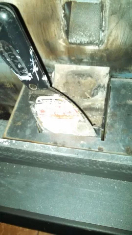

Ok running on Manual 2, seems to be where I get the best flame, there's a 78 second rotation. There's a small gap around the burnpot that's a little less than 1 scrapper blade width in the front and a little over 1 width on the side. I've got the damper just a little over half open, seems to be on the edge of running a little dirty and blowtorching. It'll have a nice flame for about 5mins, blowtorch for a min or two, then run nice again. Has just a little black soot on the glass but the may have been from before I found the sweet spot.
That gap is going to be an issue.
