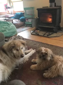

I’m happy to report back that everyone is fine. The dogs are back to sleeping in front of the stove, and I’ve been reading some of the responses back to my wife. Obviously a bit of operator malfunction, but my wife’s response “it’s a wood stove, I should be able to put wood in it without it blowing the top off” is kinda on the money, too. Fortunately, there was a half a five gallon bucket of refractory in the garage, the repair was NBD. Pull off the stones, clean old mud with the grinder, clean cast iron frame, mud the frame, back butter the stones, drop them in, beat them flat with the rubber mallet and 2’ level. Then wait an hour, small fire, let it cool to room temp. Then fire it up! Glad the stones or glass didn’t break. It is just that1/8” refractory joint holding the lid on these stoves. We’re only half way through the season here, I’m glad I can keep this running for now.

It didn’t have Stainless splines between the stones? Hearthstone uses a specialized refractory cement that is made with soapstone dust. It’s really good stuff. You may consider rebuilding the top this spring with their cement.
