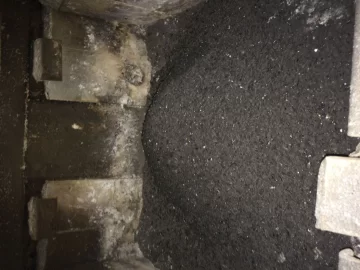

My best friend and I both have wood stoves, I run a blaze king princess and he runs a englander 30nc, we both have been heating with wood as a primary source for 4 seasons each, that's where the similarities stop... He calls me anal for having at least 2 seasons worth of wood, always gathering early and keeping neat stacks in dry areas of the yard. Earlier this year while he was over at my house he helped me clean my chimney, I got about 3 cups of grey / hint of yellow ash with a tiny bit of black creosote out of the stove. We just did his chimney and well, let the pic explain itself, about a gallon and a half of just creosote came out, he was very surprised and now since he has a little baby he will be changing his approach to burning wood.

I heat approx 2,200 sq ft, I start on November and I'm still going today, I burn between 4.5 & 5 cords of mixed hard woods, it all has been spit and stacked for at least 2 full seasons, he heats approx 1,100 sq ft ( poorly insulated and very leaky home) he starts the same time as me and prob goes thru about 5 cords and normally runs out sometime in February depending on how cold it is. The main difference between the 2 stives is the heat curve, his gets very hot very quickly then peaks and dies down, mine stays very steady throughout the whole burn cycle.
I'm no expert , but I don't think it is creosote. Looks just like ash from here.
IF that is from 5 cords it doesn't look all that bad at all. It absolutely could be better don't get me wrong but i take way more out of allot of chimneys that have had allot less wood run through them.

Your stove is cat, his is not - Correct? My friend runs an old VC Cat stove and the pipe is squeaky clean after a year of burning unseasoned wood.
While it may be more than others, I've pulled almost a full 5 gallon bucket after a month or two with our old wood furnace. We have a 32' chimney and where I would pull gallons, we now pull cups with the newer furnace. I don't think it's excessive for 5 cords of wood.

The stuff we pulled out of his box was like nickels and dimes ( chunky not ashy)
Creosote/soot accumulation also has a lot to do with stove/chimney setup. If your chimney is inside and is 18 feet while his is outside and 30 feet, it is obvious he'll have more.
His cleanout looks like some light creosote with soot.

The NC30 is a very efficient stove and very capable of burning clean so just properly seasoning his wood will likely make a huge difference with no other changes.
That much creosite would be perfectly exceptable to many and I get that but for me personaly, my goal is to run a complete season before shutting down to clean and not have anything in the pipe at the end to be of concern. An easily attainable goal with a modern stove and helps me sleep better on a cold Febuary night when the stove is cranking out the heat.

That doesn't look too bad for a season of burning to me. I burn 5 cords and that's about what I end up with dry wood.
