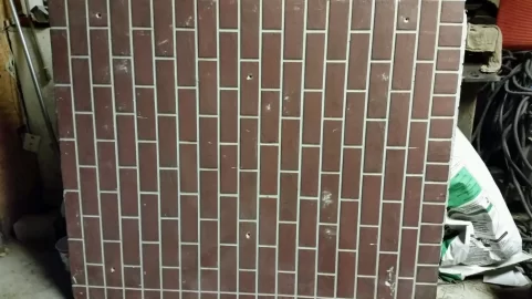

How do I know if these wall boards are made with asbestos?
  • [Hearth.com] Wall Boards - Asbestos?
Have a pro look at the only way to tell for sure .
If it is asbestos Do not use it do not move it
Have the pros handle it not good for your health
A professional needs to take a sample of it and have it analyzed. At the lab, they examine it with a microscope and look to see if it's asbestos. Best to leave it alone until then. The danger with asbestos is when it's disturbed, or deteriorating and the loose particles can get into the air.
Reactions: Warm_in_NH
agreed, although that is a non friable material and would be safe to move as long as you do not crush it creating dust. There is more asbestos in the air from brake linings then that panel will ever create. Standing on the street corner waiting to cross gives you more exposure. As a homeowner you can throw it away with your trash, I would at least put it in a plastic bag. Unless you really need to know, just dispose of it as construction debris. Do not reuse it unless it tests negative.
Most of the asbestos issues were from workers exposed to lots and lots of it over their careers. Not from a homeowner tearing out a wall of it.
You know, most of the water pipes in this country are Asbestos Cement. That water you drink probably washed down a pipe made of asbestos, OMG!
Don't cut it with a circular saw, do break it into chunks, and dump it like garbage. If you must know, try to burn it. If it burns it is most likely not asbestos. Then keep burning it until it's gone.
