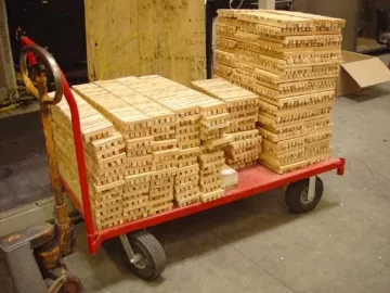

I would not worry about using the manufacturers specs. They definitely burn that thing a LOT hotter than you can using these oven-dried babies.....
