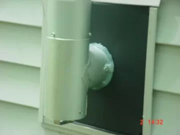

this is mine

I just did one and mine looks like the pic as well and like the pic I used high temp clear silicon.

to the untrained eye, it may seem like theres no silicone around the thimble also i applied grace ice and water shield undrer the siding
so there will be absolutely no water coming in
