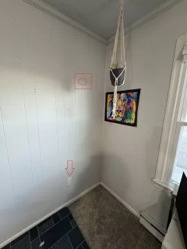

The wall cavity I would like to put my thimble also has an electric outlet, what is the install specs on this? Can it be done safely? I was planning on running my pipe up that wall inside and out the thimble at the top of the wall (not at bottom near outlet box). If the romex has been stapled to the left side of the 2x4 would it be OK to install the thimble towards the right side of the same cavity?

I have attached a picture of where I would like to install my thimble to double check if this is OK?
I will be doing a corner install of the pellet stove, I have a corner hearth pad I will be installing this weekend.

Honestly I don't think it would matter left or right of the 2x4. The thimble protect anything there..
