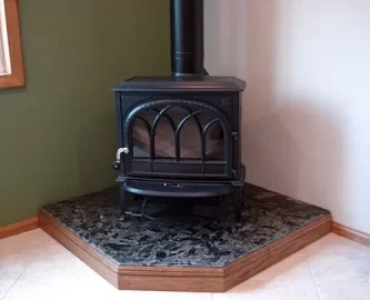

We installed our Castine according to the specs, but the wall still gets too hot. The wall is standard drywall, which should not be heated above 125 degrees. Our wall gets to around 140 degrees.
My wife loves the look of the plain walls, so she doesn't want to put in bricks or anything n the walls.
can I remove the drywall near the stove and replace it with some kind of "rock board" that will handle the 140 degrees?

The pipe is okay. The heat is coming off the side of the stove. It sits in the corner diagonally, nearest corner is 11 inches away from the wall - as per the makers install instructions, for a stove with the double-wall pipe and rear heat shield.

Correct. I'm using an infrared thermometer and it's reading the surface.
I guess a piece of sheet meal, spaced one inch from the wall and painted the same color wouldn't look too bad, but my wife likes the "clean" look we have now.
  • [Hearth.com] Wall Too Hot!
That's very similar to the way our Castine was installed, though I increased the spec for corner to wall distance a couple inches. A tiled wall shield would look pretty nice there and could link the two different colored walls with the right tile choice.
