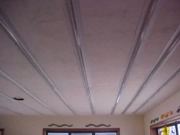

I have ceiling radiant in my home. Third winter on it. I installed it when my wife was out of town hoping she would never notice it, since it is exposed! She tells people she feels like she is living in a broiler. Because of the look.
I have to tell you, as a long time radiant floor installer and owner, they work very well. This is PAP in extruded aluminum transfer plates. Spacing varies fron 8" on the perimeter to 12" as it moves in.
A few advantages.... you can run them a bit warmer, since no one typically walks on the ceiling. So you can get some good BTU/ square foot outputs. Floors are lim uted to about 83- 85F surface temperatures.
No one puts carpet or furniture on the ceiling so you get a lot of square footage emitter.
Properly install it hides nicely and a change of floor covering does not effect it.
It is much, much faster responding than a radiant concrete slab, low mass accelerates and decelerates quickly.
hr
Wow- does your wife have any single siblings, or cousins, etc., willing to move to the snowy north? I really need to meet a woman who is similarly tolerant of innovative projects!
