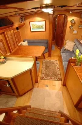

If you are thinking of walnut for flooring, consider the sunlight exposure. One downside of walnut for interior work is that it bleaches out over time. We made a custom yacht with a maple and walnut interior in 1990. You would hardly know that it is walnut in some areas 23 year later. I don't have the original pics digitized, but the difference is major. Here is the current shot. Note the difference between the table and the louvered doors.
I'm suprised to hear this - Do you remember what type of finish was on that walnut, BG? It doesn't even seem like there would have been much sunlight exposure in that room.

What I've discovered over the past 30+ years is Black Walnut gets lighter when exposed to strong sunlight,Black Cherry darkens fairly rapidly.Mulberry & Osage Orange/Hedge will start out that brilliant yellow or yellow-green but will start to turn reddish to golden brown in just a few hours or days,finally a chocolate brown after several years.No varnish,lacquer or clear Danish oil with prevent that either unfortunately.
