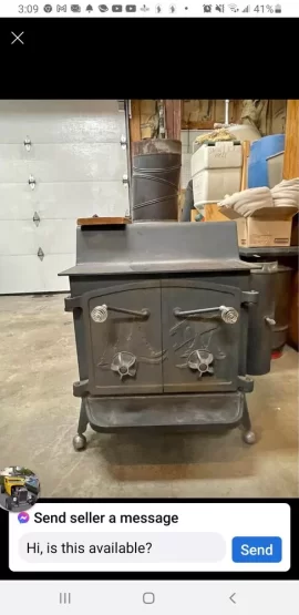

No if it doesn't have a ul tag on it it isn't listed. Even if it was originally.Can they be retrofit to meet UL?

Where would you look for the UL tag?No if it doesn't have a ul tag on it it isn't listed. Even if it was originally.

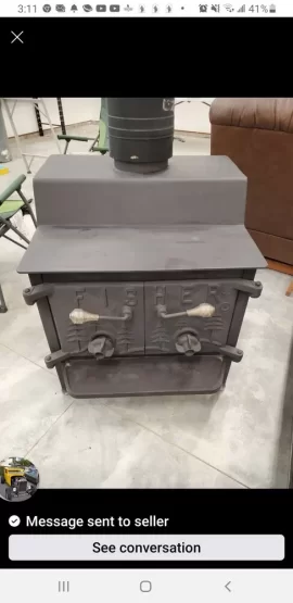

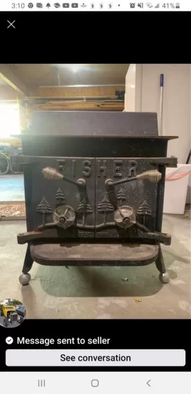

) might work??They are usually on the back of the stove. I am not sure about fishers but coaly will knowGot overzealous and put an offer on one last night and committed to buy, not expensive. Might want to sell. Wondering where a possible UL tag might be? Wondering if Wyoming or Montana or New Mexico (we have family in NM) might work??
ThanksThey are usually on the back of the stove. I am not sure about fishers but coaly will know
