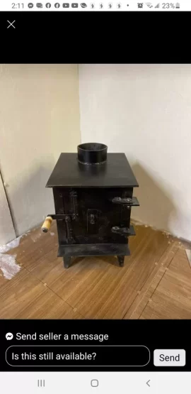

The other thing looks kind of like a pizza oven
Reactions: FisherStove
The one was made after 1990 because it has a EPA compliance label. That is better than pre EPA.
Are you sure that's a hearthstone? My guess from the look is that it is a more modern more efficient stove. But I would have to know the make and model or atleast see internal pics.
He says it's got all the stickers. Only had a fire in it twice. Guessing he's not home to send pics.
Why is he selling it after only 2 fires? Sounds fishy
It just doesn't look like any hearthstone I have ever seen. The glass looks really dirty for 2 fires as well

So you want an old (pre-EPA) stove. E.g. a Fisher. Ok, not my choice, but preferences exist.
Then you post many pics. All of which essentially result in a comment "that's an old model, it'll be inefficient, check for cracks". Because really judging the (remaining) quality of (or life in) a stove is tough based on a few pics like that.
I think it's time to write down a few guidelines based on which you can choose (and take the risk). And because I have the audacity to propose this, I am obligated to start - despite my far less knowledge of old stoves. (I.e. others will correct me and expand on this list.)
- Check for warping of panels
- Check for cracks
- Check for white spots (due to overheating)
- Check seals (of cast panels w/ stove cement and gaskets around doors and windows); this is not a show stopper as you can fix things but you want to know before how much work a stove is going to be to get operable
- Check if it's a coal vs wood stove
- See how large the firebox is (so you can estimate a bit the heat output and duration, going by volume and performance of similar old and inefficient stoves)
- See whether the flue is top or back side, and what size. Does it fit the place where you want it to go. Same for clearances (which will likely be 3 ft all around)
- Consider side loading, front loading, (and E/W vs N/S with respect to the door opening), and associated hearth sizing (likely needing to be insulated, and if not at least spark protector) needed for the candidate stove
- Consider split length that can be loaded

Then still, I'd be hesitant to make decisions based on what someone says in the net judging from a few pics.
So a list of "pay attention to this" is I think a more useful approach than asking "this one? or this one? or this one?" and receiving "fair, mwah, coal, pizza oven, dirty glass" answers. I mean I don't criticize the answers you give but the point is that they are not really helpful in providing datapoints based on which to decide whether to buy a stove or not.
