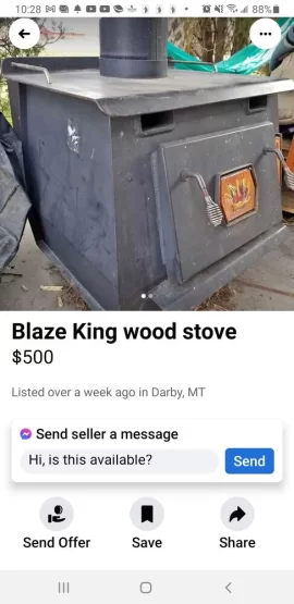

Blaze kings are great stoves for long low burns but they are not that great at high BTU output. There are also much cheaper stoves available that are still very goodLooks like a price range maybe. Much more initially than used Fisher but they can be installed
![[Hearth.com] Want to get a Fisher [Hearth.com] Want to get a Fisher](https://www.hearth.com/talk/data/attachments/294/294995-4a1aa419120a140189680717d180c7f5.jpg?hash=mugH0UFmZt)
That is a really old blaze king. It's going to have about the same efficency as a Fisher. I don't know if that one is listed. It's possible but not something I would want to use to heat my homeFound this one. I asked if it has the UL tag and sent pic.

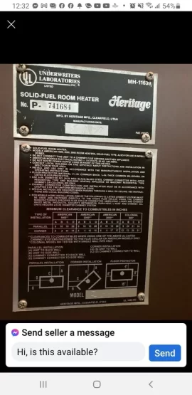

For better efficency you will want to be looking for EPA approved stoves. Mid 90s and up. But there were still some of those that were not great performance wise. They did well in the lab but in real world use they didn't work out.I'm seeing some old ones with UL tags. This ones '82, I think. How new should we be looking for efficiency? 2000 on? Or 2010 on....

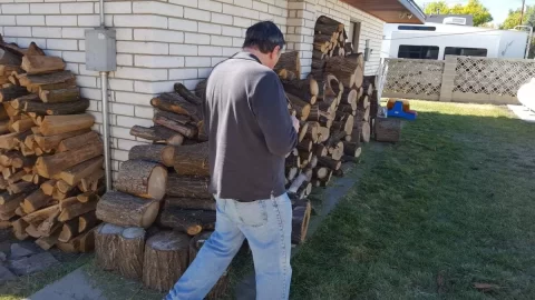

Yeah Chinese elm will burn. Not great but content but it will work. Is it dry?Chinese elm. Not the most high quality but should burn, I guess. I guess we'll get our chimney checked out and see what we can do. We've been appreciating your advice.
If you don't mind saying what did it cost you?
Should be quite dry. It's been a couple years since we chopped it. 2018 or 2019Yeah Chinese elm will burn. Not great but content but it will work. Is it dry?
If the chimney you are referring to is that fireplace it will need an insulated stainless liner in order to be used for a stove or insert
If it was spilt and covered in 18 or 19 it should be fineShould be quite dry. It's been a couple years since we chopped it. 2018 or 2019

The old Blaze King's can run with the old stoves, no problem.Blaze kings are great stoves for long low burns but they are not that great at high BTU output. There are also much cheaper stoves available that are still very good

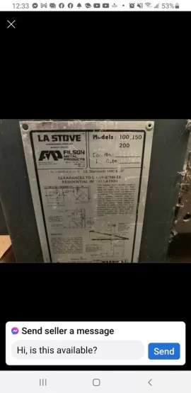

100% of our stoves, wood, pellet and has have safety test lab approvals.That is a really old blaze king. It's going to have about the same efficency as a Fisher. I don't know if that one is listed. It's possible but not something I would want to use to heat my home
I didn't know if all of the early ones were ul listed or not. Good to know100% of our stoves, wood, pellet and has have safety test lab approvals.

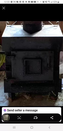

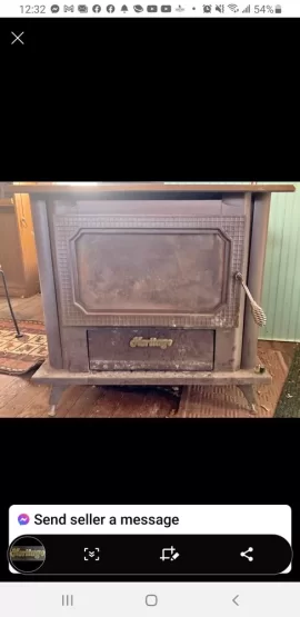

Are you sure that's a hearthstone? My guess from the look is that it is a more modern more efficient stove. But I would have to know the make and model or atleast see internal pics.Hearthstone brand
The Vermont castings Aspen is a good stove but it's tinyHere are a couple more. One is a propane
