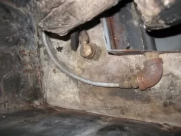

Last weekend I cleaned it out for the first time. The previous owner laid lava rock and sand in the bottom and it was a mess, but I we got it cleaned out. in the bottom there was a steel pipe with holes. There were some brass fittings connecting the steel pipe to the gas service into the firebox. I called up the local sweep and asked how much an inspection was and told them I wanted to keep the gas burning ability, but also burn wood. The lady asked some questions and informed me that the steel pipe is a log lighter and not a retrofit for gas.

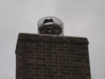

So I am planning to have the fireplace and flue inspected before I start throwing logs in. Attached are some pictures of the fireplace and the chimney. I have a couple concerns and a question.

1. Will the brass fittings stand the heat from a wood fire in the fireplace or do those need to be a different material?
2. Refer to the picture for the chimney cap, but has it been retrofitted so I won't be able to burn wood?

That's not a log lighter in pic #1, it is a burner pan for a set of gas logs. The supply tubing is aluminum. If you're going to burn wood in this fireplace, you'll need to remove everything, including the brass el at the introduction point, replacing it with a black iron pipe cap. Make sure you locate the shutoff for this line and close it.
The cap is a Vacu Stack draft inducer, and is suitable for a wood fire. I'm not sure what that arched thing (mesh?) is standing up behind the cap, and can't imagine what its purpose might be. On second look, it appears it might totally surround the cap, acting as a spark or critter guard? If that's the case, you can achieve the same result with a less-unsightly cylinder of mesh on the inside of the cap.

Thanks for the input. I will get the chimney sweep out and figure out how to plug the gas line going in.
The mesh is a critter guard from what I can tell.
