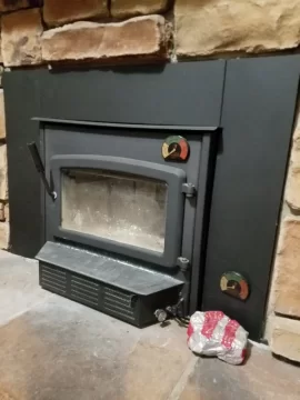

Are you mechanically inclined/can you install yourself? I installed a Century 2900(another SBI company) in my existing masonry fireplace. Was well under your 3k limit, although that was a few years ago.

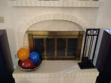

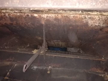

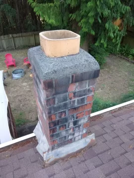

Hmm...I hadn't thought about a DIY install. I've got moderate mechanical ability and like a good project, so maybe I should give it a shot. House was built in 1975. The fireplace front opening is 36"x 28", and the firebox is 23" deep. Chimney is about 13 feet tall (from the bottom of the hearth up to the top). Flue is 11" x 11". There's a steel damper in an opening that's about 11" x 30". Looks like removing the damper could be quite the project in itself.
Now I'm thinking about knocking out that "arch" over the fireplace, and covering it with a stone veneer. Should probably do that before installing the insert.

That's a perfect candidate for a diy install!
You'll be surprised how easy that damper comes out!
With a chimney that short you will probably have to put a class A chimney pipe extension on it to get to a minimum of 15-18' tall...they make an adapter to do this...not that big of a deal...
Looks just like my damper was. Assuming you are in a ranch if you only need 15ft of liner. I say do the install yourself with another set of hands. I got the insulation kit with the liner on Rockford. Hardest part was moving in such a heavy stove. I knocked a couple bricks off the back side and grinded a little bit of the damper frame. Done in a day. I got my enviro on Facebook marketplace.
The Escape 1800 insert requires at least 12 ft of liner from stove top to chimney top. Measure again. You are close. It might work without an extension to the liner. Definitely insulate the liner to help performance. I'd also plan on adding an insulated block-off plate in the damper area.
