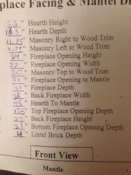

I just re took measuments. The depth measurement was taken at the top. The top is slanted in some and measures the 17 and at 4 inches down goes out to 18" while the bottom measures 21 inches. Didn't relize the difference at first.

Life got in the way, but I got some measurements hopefully these makes sense to some one and they can offer some more ideas for a great stove
