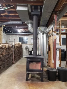

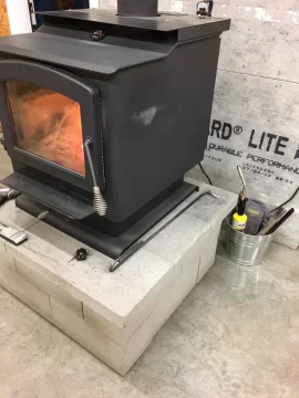

Highbeam, I very much admire the simple functionality of the hearth you put together for your NC30, and I think I would like to use an identical base for my 2014 Drolet Austral (which currently sits on a concrete floor in the basement). Is there some sort of minimum height that must be adhered to from the top of the stove to the bottom of the ceiling box? At present, I have 61" from stove top to bottom of the ceiling box....

Some stoves for sure, maybe all, have a minimum distance from stove top to ceiling so you would want to respect that. In my shop, the permit required an 18” tall hearth but my ceilings are 14’ tall so no problems with ceiling height. I really like the height for loading and looking at the fire through the window.
The stove in my house is on a raised hearth too. About 10” above the floor. I just barely meet the manual requirements for distance to ceiling on that one.
