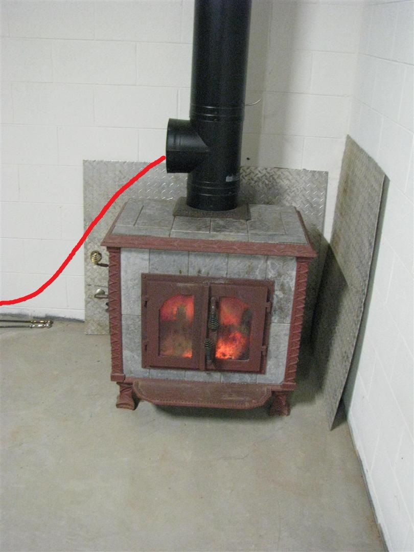

Yes, that's the whole idea. The 3' rods are fiberglass, so you can not bend them 90 degrees, but you bend them into a big arch and shove them right up the flue. I did mine this way & I found it easier to put 12' together at a time, then start on the other side of the basement, and just walk towards the stove while spinning the drill. Walking back & forth gets it clean, then add the other 12' and continue on up.
The angle of the rod is in red:

If I didn't have the "T" I would have to take the baffle out of the stove. It's not a bid deal only two bolts, but it is time consuming and messy.

for my install, yes. i just open the damper on my defiant and let 'er rip. i would guesstimate its bending at about 60 degrees or so max. it helps if you have several extra feet of rod so your spinning the sooteater from 5-6' away and keeping the drill down low to the ground. the lower the drill the easier the angle is on the rod.

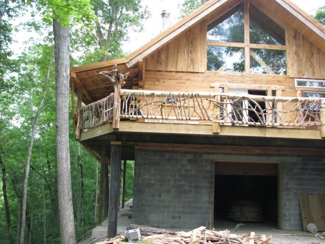

Begreen, winter or not, my flue cap is in a bad spot. When I stand on the porch roof, I can't reach the cap so I have to screw stops on the roof to stand on. If i slip an go off the porch roof it's about 40' down to a steep embankment, then 100' down to a creek. Needless to say I don't like being up there even though I am the one that built it.........::-)

Not the best pic, but the flue is just to the left of the big windows.......
love your place - the top rails and posts are really cool....

The "T" ain't pretty but it sure is functional. Barky did you just come down off the roof? B of H thanks, the most fun part of the build was scouting the woods for cedar logs/sticks that wanted to be a post,railing or baluster then building them. The corner post are cedar blowdowns from a storm at least 15 years ago. All the sapwood was gone leaving just the red heartwood.
