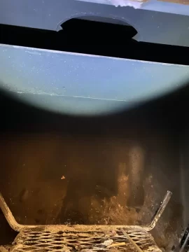

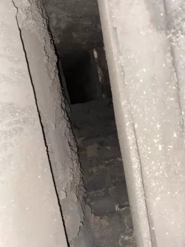

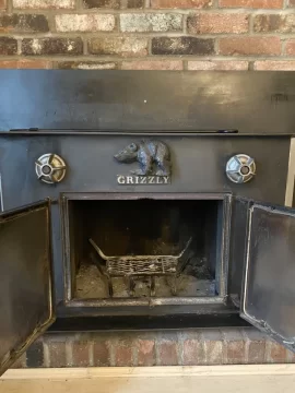

Thank you for your replies. I took some pictures.
[Hearth.com] Was I ripped off by a chimney sweep company? How to clean chimney with an insert?[Hearth.com] Was I ripped off by a chimney sweep company? How to clean chimney with an insert?[Hearth.com] Was I ripped off by a chimney sweep company? How to clean chimney with an insert?[Hearth.com] Was I ripped off by a chimney sweep company? How to clean chimney with an insert?
My guess is that all creosote is falling on top of the insert
Well yes you did get ripped of sort of. To clean an insert like yours properly the insert needs to be pulled out and everything cleaned. But to do that would cost way more than the 140 you were charged. We will no longer clean setups like yours but if we did I would charge about twice what you were charged.
Now about your setup. The sweep should have told you that what you have is unsafe to use and is not code compliant any more. Most like us will nolonger work on setups like yours which are referred to as slammers. This is because of the safety risk to the customer and the liability risk to us. You really need to have it installed properly with a full insulated liner.

Also, from the picture, would you be able to say if I have a lot of creosote build-up in the chimney?

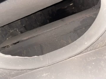

In your third and fourth photo, I can see the smoke shelf damper is long and narrow.
A metal liner would need to be pressed somewhat to fit the end of the liner down through the damper, the part that attaches to the top of the stove, then before making the connection to the stove re-rounded.
Many inserts have 6 inch round exhaust ports, and on one of my fireplaces its damper was only 5 inches across.
It is not a big problem, but it likely would need to be done... wouldn't know for sure unless you can measure it and the diameter of your insert's exhaust port.

It is far better practice to cut the damper out so you can keep the liner round.
