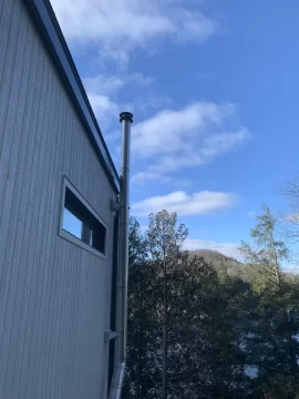

This is the cap i have.

Yes, probably the same as we have.

I have one of these and we don't get rain in the chimney. We do get water dripping from the outer ring as the cold wind causes the moisture in the flue gasses to condensate almost immediately. This is my only complaint.
It must be then the combination of high wind and rain. I am just worried that if the ice builds up to the top of the clean out then water might start coming into the stove. Sometimes i am not here weeks at a time. I suppose i could remove the clean out lid when i am not here.
