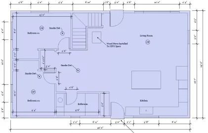

The layout for our house is attached. We are around 900 sq ft on the main floor, with a 22'x14' open loft above the bedrooms. The ceiling in our great room is 18' at the apex, 8' on the sides. We have a ceiling fan going on low in the great room to stir the hot air back down.
We heat with a Progress Hybrid by Woodstock. At first, we looked at their smaller version, the Fireview. But after talking with Woodstock, they suggested sizing the stove a bit bigger than what we thought we might need. I'm so glad we did that! Since this stove is our only heat source, it would really stink to have bought a smaller stove. We've been below zero outside for 50+ days this winter, and not once has any corner of the house been chilly.
Love this stove. Love the layout of our house.
