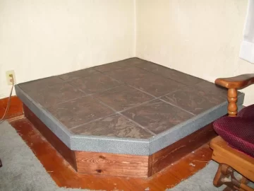

Oh man, so sorry to hear about the delay. Good thing the guy didn't have a 365lb. stove fall on him and he's going to be okay. Give a push on all the stones, top, bottom in and out and pay particular attention to the ceramic sheet above the burn tubes. I'll pray they can come on Monday, but in any event, post us some pics of your hearth pad to wet our whistles, okay?
This is the hearth pad I built. It has 2x4 framing, followed by 3/4 cdx with 5 layers of 5/16th Duroc with 1/8" thin-set between each layer, another 1/2 inch of thin-set (my floor wasn't totally level, my pad was perfect :coolsmile: ) and 1/4 inch ceramic tile. Trimmed in 1 x pine, and the pad trim painted with touch stone paint (I hope it matches the stove). The pad sits about 10 inches off the floor and the carpet comes up this next spring and the hardwood floors refinished!

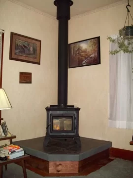

New Tribute is in and first break in is done! We got the surface just warm to the touch, well maybe a bit more then that, but not hot. Allen (the dealer/installer) told me to make the second a bit hotter and the third a bit hotter yet. Does that sound right to you? I will post up pictures tomorrow if I can get my wife to help get them into the computer. (read... it is a technology thing!) This project has been a blast from front to back. We had some pit falls and delays, but it is all worth it now! Two more break in fires and, by Sunday I will be basking in the glow of warm, radiant, wood fire heat! :coolsmile:
I think I figured out how to do this. This is a picture of the new stove, and the first break in fire!

Thats a great looking stove, I like how everything matches the trim color on the stove. congrats, i bet you can't wait to get a rip roaring fire going.
Wow! It came out great. Doesn't it look just like a mini Heritage? Good luck with her.
I can't wait to put some wood to it and see what it will do!!!!! The break in thing is driving me nuts! I know be patient weed-hopper. I believe this is the beginning of a beautiful friendship, and a great new lifestyle for us. (and it looks good too! :coolsmirk: ) but I still can't wait to fire this thing up for real. Two more break in fires today, and a full load of elm is on the schedule for tomorrow! I will post just how that goes.

Ya, that sounds right to me. My manual says to cure the stove with a few moderate fires. My first was just with a pile of kindling firing it up and let it go completely out. Second fire was a couple small splits, and the thrid was full load.
Your stove and hearth looks nice. Welcome to lower fuel bills!
