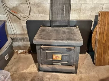

I've been looking for a new wood stove for a while, the people who lived in my home before me didn't install theirs right and in roughly have a 6 inch pipe, sitting inside an 8 inch chimney pipe. Anyways I found this 8 inch earth stove that rear vents which would be perfect for my needs. My only issue is I can't find the model number... Anyone have any guesses as to what it is?

Cant help with any additional information but is there ANY labelling on the rear?? Any plates?

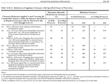

If none can be found this stove appears to require a 48" clearance around it as it is not a self shielded stove.
You can install but you will need to install a Code Compliance 66% reduction shield of metal behind it to be 18-20" above the top surface and 20" wider than the stove body. and mounted as per the picture below.
For your old 6" stove, I would have just installed it on the 8" chimney with a 6-8 increaser on the black pipe.
