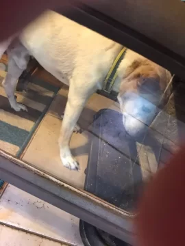

Return to den, stove cruising@ 500F, secondary's super engaged. And then I notice that the fire through the glass is distorted.
*pics taken next night*
Look from behind Old Man Sam's ear, down to his front paw.
