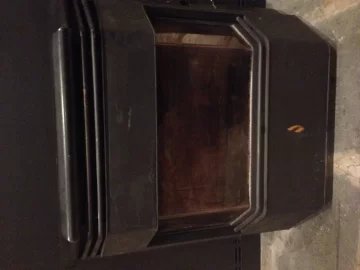

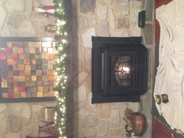

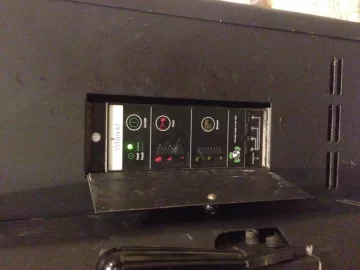

Give use a picture of stove and control?
Are you familiar with what your flu output volume of air is, such that you could go outside during a start up attempt to see if it is drafting. almost sounds like the draft blower is not coming on to black up that fast. Bioburner here will be good help if you can answer the questions coming your way.
Here is a pic. Do you need a close up or is this good enough?

Looks to be a profile series. Have to see what I have in the computer for manuals.
I see your pictures, yes, obviously a chimney out the roof arrangement. Sounds like you are familiar with running this stove, could you verify the combustion blower is running and does it seem to be drawing, ..... I can tell a difference in the sound of mine when I close the door tight -vs- opening it. also you can see a significant difference in the flame cracking the door open when it first starts to fire up, fire is very lazy with door open and the draft really makes it stand up and gives it direction when the door closes and seals. This is not scientific but kind of a crude way of checking for normal flu draft when you are familiar with your stove... Silly question but there is no chimney cap slowing the exhaust is there ??

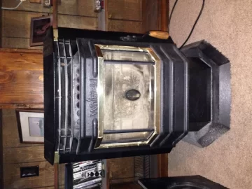

Hard to tell from pic (please upload better ones, with lights on or flash) but I thought it might be a Quest, similar to one I have. Open hopper and see if anything written on underside of lid (sticker).
Writing from iPad now so cannot get manual to upload, but am skeptical it's the board. You say it runs for 5 min, then stops and restarts? Please give more specific info. Count (or use stopwatch) to tell us # seconds between auger turns. How long does it stay running, specifically (5 min sounds like an estimate). Exactly how long off until reigniting? Exactly how long does it stay relit? And please describe flame, etc., while this is going on, in detail. And when was stove last thoroughly cleaned?
Think the Quest has a heavy cast door?

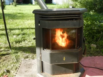

My ugly camp stove a Profile 20

Better pics - will answer other questions in a sec

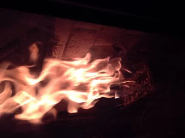

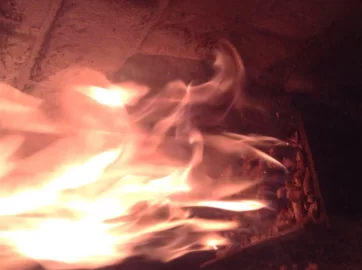

Starting it again now. It hasn't lot yet but the hopper is FULL of pellets which is not normal for this stove. It's always dropped too many to start, but maybe a quarter full. This is pretty much totally full which I guess explains the huge initial flames.
Waiting for it to start to get timings.
First pellet drop was in 27 seconds. Drop continued for 30 seconds. Burn pot totally full, some I burned pellets falling over burn pot sides.
Only 1 pellet drop before it burned out (burn pot mostly empty). Burn time was almost 8 minutes.
This time it hasn't restarted but has gone straight to fault mode.
The last two times it died the whole way down and then dropped more pellets and recovered before dying again.
This is a hopper fire waiting to happen, yes?
That happened once before after a professional clean and burned the label off the lid. He came back and re cleaned and it didn't do it again but these flames are fierce and licking the passage back to the pellets. : (

It was taking two shots to light when things were going well.
Now it's lighting first time but with triple or quadruple the number of pellets.

I'm trying starting it on low (it's never performed well on low) and then changing to medium or high but it's still dumping a ridiculous number of pellets.
