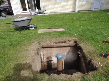

So I've been noticing the ground around my well pump has been sinking a bit. Just recently it has gotten very bad.
Here is what I have so far- it looks like there's about a 4 by 4 concrete wall around the pump. If you look at the picture I believe the pump is the round brown circle in the middle of the square depression.
Last owner said that they were oak boards covering the pump. They have obviously rotted out and now are useless.
What should I do about this? Just go buy some more pressure-treated Oak boards and cover it? Why isn't it filled with dirt anyway?
This is the first time I'll be working on anything regarding my well, so any advice would be appreciated.
Thanks in advance!

If it's sinking around the well, you may have a leak that is undermining things. If you can, see if the well motor runs when there is no water demand in the house, over a period of time. I had a similar situation where the pitless adapter leaked. There was no undermining, but the water came up to the surface and I had a mini pond around the wellhead.
Is it sinking around the well? I don't know. I don't know if the boards just broke. I haven't opened it up yet. It looks 3-4 feet deep. The grass has been dry but there is plastic that is under the grass but over the boards.
What is a pitless adapter?

I have little idea what they do about well heads in other parts of the country, but that looks either like a dug well, a cistern, or septic tank. In this part of the country, there is usually an access point where the well can be accessed for maintenance, and the same holds true for cisterns. Only septic tanks are covered over.
Do a little digging and post a picture of what you find.

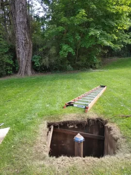

I talked to the previous owner. He confirmed that there is 3-4 feet of unfilled space around the underground well pump head. So it seems like the oak boards that were there just rotted and broke.
I likely need to make a new cover. It's around 5x5. I would love a high density plastic but I think that is going to cost around $500 or so.
Any ideas? My best idea is to get 2 sheets of 4x8 pressure treated plywood, cut it to size, and double it up to cover the hole completely and give it strength. Use root resistant screws. Silicone the seam, cover with plastic sheeting, then cover with sod.

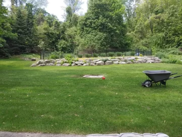

Hi Bad LP, thanks for responding. I have a really nice back yard- it would be a huge eye sore and put a wrench in playing ball with my kiddo.

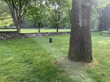

[Hearth.com] Well pump issue outside- advice pleaseSometimes the family health needs to come before play space. This was just above grade for years and I just had it raised to 18” for inspection purposes.
Now to build a guard to protect the electric feed from the landscapers.

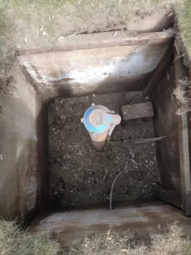

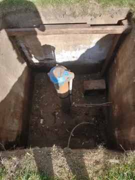

Like they said above it should be raised... you can always put a wishing well around it for decoration... If you must leave it below grade get some cedar 2x6 or similar rough cut if you can find it. It will take 10-20 years before that fails...
Reactions: mwhitnee
What company makes that?
I think the one in the pic is Hubbell Quazite but you can get them from other electrical equipment manufacturers. It's basically an underground splice can with an open bottom. Not cheap but you can drive a tractor over it all day.
Reactions: mwhitnee
I think I might go with cedar boards, the plastic covers are not big enough and expensive. Would using pressure treated green board really be a factor with toxicity? It's a 140 foot artesian well.

I would not hesitate to use PT planks in this application. If your well has natural positive pressure then there's a very low risk of contamination with surface water.
Why would any health issues be an issue when the top of the well is sealed?
It's vented on the under side or bottom of the mounting flange unless its an old school cap that was open with no gaskets or screens.
If it was sealed tight how would a vacuum not form from withdrawal or vise versa, what would keep the top on when it refills?
Now I realize your well may not be a drilled well thru bedrock but given your location I suspect our wells are the same.
Be careful digging in there. Lotsa electrons in those wires. ;)

That well head looks to be in pretty good shape. If it were my house I would just build a new pressure treated deck over top of it supported by the concrete. Should get another 50 years or so before it needs replacing again. If you intend to cover it with grass just take some measurements off the house or other fixed landmarks so you can find it and don't back a concrete truck over it by accident.
