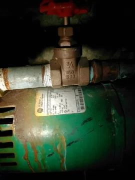

The pump appeared to be leaking around the shaft that goes from the motor to the pump. Maybe it's just in my head but the pump sounded much rougher running too. Now I think about it I wonder if just the pump head is replaceable? It's pretty old though I wonder if parts would be available. Not sure if any of this stuff has a universal standard. It's a shame because the motor and pressure switch, etc, are still quite functional would be a waste to just throw out a perfectly good 1/2 hp motor.
Here is a shot of the label best I could get at the time, I don't see a flow rating unless it needs deciphered from some of the info there that isn't obvious, or its blocked by the valve.

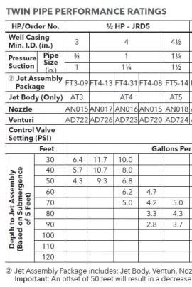

Still wondering about the Jet package, do you think I could just hook the pump up to the existing pipes and try and see? Looks like they have several jet packages to match different depths and flows. These 2-line pumps seem like a pain.

Oh I posted link to the pump, if you want the jet packages I hadn't even looked at them. There seem to be several based on min casing size and depth, but I do not know either off hand. I guess if I really need a jet package matched to this new pump I'll have to figure it out.
Oh man, these are expensive wtf! I looked up the first jet package listed (from the pic in my last post) FT3-09 and it cost almost as much as the pump, just for that?!? https://waterpumpspro.com/index.php?main_page=product_info&cPath=57_19_29_116&products_id=2572

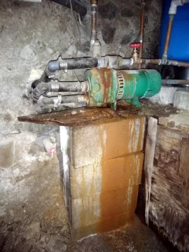

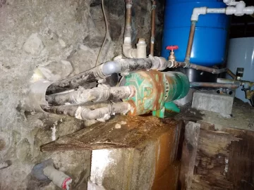

Actually when I was just down there I tried to take a couple pics and realized there was a label on the front behind the pipes... its a Myers HR 50 D. Its filthy down there and hard to get to the front of the pump (mucky floor, cob webs, etc) but when I did, I finally spied that label. Now maybe I can look up the specs or even see if the pump head is replaceable perhaps. Looks like it is still commonly available, and even a bit cheaper than the Goulds I was looking at. Might be easiest just to get this since everything should match up (but I still will likely replace the rusty fittings, etc).
[Hearth.com] Well pump replacement [Hearth.com] Well pump replacement
The rust on thjje body of the pump is old, but the rust running down the cinder blocks is all new and from the water that was leaking the other day. I have so much iron in water I suspect when I shut the pump off for a couple days the iron must have clogged the leak - hasn't leaked since but I still want to get a replacement.

Id replace the whole thing.
Youll need some additional black pipe its pretty hard to reuse. A plumping store will sell it by the foot its very cheap it will save you some headaches.
Youve got a lot of issues going on with how its mounted it really needs to be on a stable mount. Wood is a no no. I suspect you probably know that so Ill stop here.
I don't see any black pipe anywhere, check out the pic in my last post. I assume you're talking about the iron variety of blackpipe, not the black plastic pipe that can be seen in my pic with the hose clamps on it.
Taking a closer look at my pump now that you mentioned the mounting, it isn't actually mounted just setting on that old wood. But no, I am not really familiar with mounting requirements for pumps, I'll have to figure something out. Perhaps extra vibration from not being bolted down has caused the unit to start leaking.
