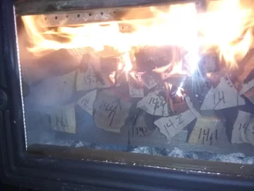

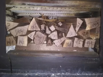

Yesterday when I stared a fire in a clean stove, I had quite a bit of smoke from the wood as I started the fire. I conducted a test today to help me determine if I need drier than normal wood for my stove. In the past I have not checked every piece, but the ones I have checked were never above 18% MC.
Stove: Pleasant Hearth WS2417; 1.2 cu. ft firebox
Chimney above top of stove = 17 feet.
Low MC = 12%
High MC = 15.2%
Most in the 14.1 % to 14.5 % range
Outside temp 30 F
Wind speed 7 - 13 mph.

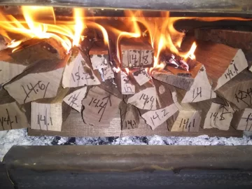

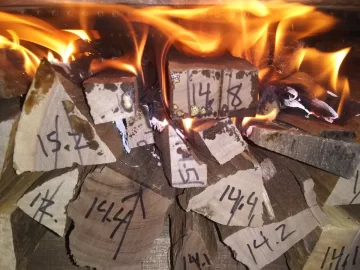

All the wood in this load was brought into the house yesterday (from garage), then re-split this morning and measured for MC on the newly split side. I marked each piece with the MC on the end. I loaded the fire box with this wood. I placed three pieces E/W across the bottom. These pieces were laid on top of three N/S small piles of coals. The coals were not hot and did not effect the start up. The MC of these pieces was 14.4, 14.2, and 14.5. The remaining pieces were placed N/S. See the first picture. Newspaper was inserted into the cavity on top of the kindling. After the fire got going a bit, I inserted a few pieces to fill the gap.

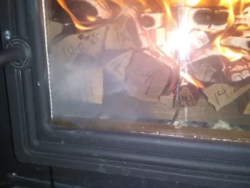

From the pictures you can see water bubbling out the ends of the wood and you can see smoke. I did have more smoke than this yesterday.
My stove always has a cold right side. I recently replaced the door seal, and today I performed the dollar bill test. It did slide out from the left side with some tension. I may replace the seal again, this time with less cement. I think maybe I used too much, and as it squeezed out and hardened, it may be binding the door on the right, which could cause the left side to not fully close. I'll have to look at this more closely.
This fire never got above 410 F.
Anyway, what are your thoughts on the water bubbling, and the smoke.

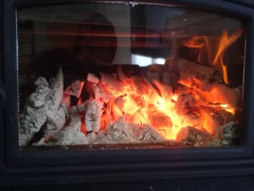

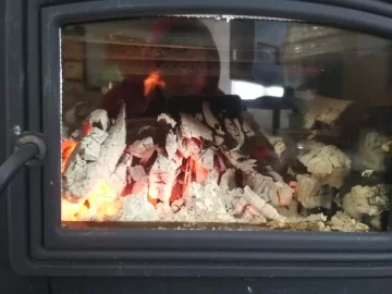

Now I have this. Very little secondary burn going on. Left front wood burned but back and right side not burned much.

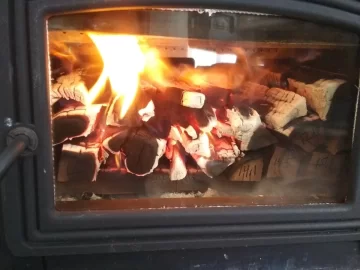

Crack the door and I get flames going.

My non-professional gut opinion tells me that maybe start fire with less wood with more air space might heat things up better. Once that burns down, you’ll have nice hot coal bed to work from.
Your moisture meter may not be working right, or you are not pressing the pins in hard enough? If you are getting bubbling, that may be 30% ish wood?
Third-party gaskets can sometimes lead to a poorer seal than the OEM gasket. And the older style gasket adhesive can over harden the gasket if applied too heavily. If you are going to try a new gasket again, get the factory replacement and use RTV silicone to adhere the gasket.
15% wood doesn't bubble out the ends and it catches like crazy, especially with a very small split size as pictured.
If you whang two dry splits together, they should ring, not thump.
Reactions: Dmitry
Yeah either your moisture meter is wrong or your testing procedure is wrong. That wood is probably atleast 30%
What moisture meter you using and on what setting? Mine has 4 settings and an initial 12% reading can end up being 32%

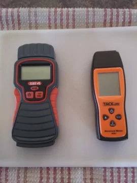

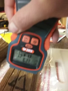

Here is the meter I have been using. The SBI. It does not show any type of model number on it. I am borrowing it from a friend who, I am sure, spent a lot more $ on it than I spent on my Tacklife.
The SBI only has one setting. I checked the battery and it is fine.
The Tacklife has 4 settings.
I press just about as hard as I can into the wood. I measure across the grain. (If the grain were my fingers, one pin would be in the index finger; one pin in the little finger. Measuring with the grain, both pins would be in the index finger. )
I just tested the same piece of wood. Results:
SBI: 12.5%
Tacklife:
Setting #1: 4.5%
Setting #2: 5.0%
Setting #3: 7.5%
Setting #4: 9.0%
The wood is walnut.
Both these meters could be wrong. What I am learning today is that the bubbles and smoke are more telling than the meter readings.

Your tacklife meter is off the charts. You'd need a kiln and a long bake to get to those numbers- not achievable outdoors unless you live in a desert.

Probe the wood at 180 degrees from the way you are currently doing it. See what reading you get.
If you don't see lots of splits on the ends of your wood then it is not dry. I don't care what the meter says. These prong meters are worthless in this situation.

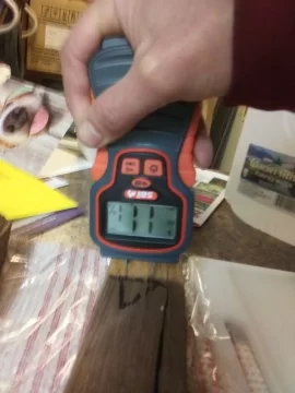

Here you go: Pics are a bit blurry cause I'm pressing on meter.
FYI: When the prongs are in water, the meter registers 50%. Anyone else ever place the tips in water? What is your reading?
Were they kiln dried or air dried? In water it should read 100% but the meter probably doesn't go that high

It is not physically possible to get that far below the average relative humidity of your area with just air drying. Your meter or testing procedure in inaccurate
