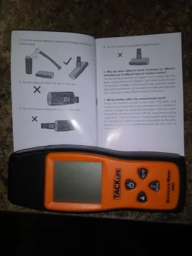

My TackLife states to measure cross grain; not with the grain. I thought that the SBI manual stated that also.

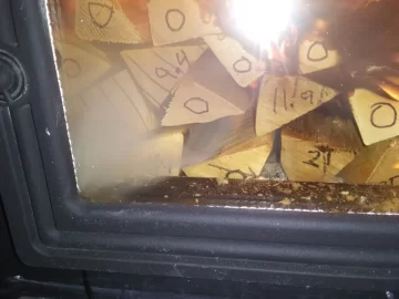

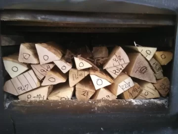

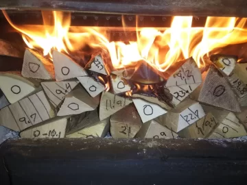

I purchased two bundles of 'kiln dried' wood today. That was a total waste of money. I cut to size for N/S loading and split some of the pieces. Made MC readings. Readings were all over the place. From 0 to 22 -23%. Pieces that I did not split registered 0% on SBI. Some that I did split also registered 0%. Like I stated, I do not trust the meters that I have. I loaded the stove and as you can see this was not much better than the wood I tested with yesterday.

Follow the manual because the meter could be designed to correct the displayed moisture reading to assuming parallel or perpendicular probe placement.
