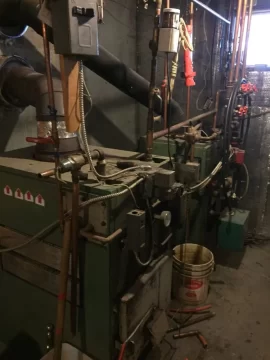

Hi everyone, I’m new here I’m having trouble with my wood boiler wf200 New Yorker. Should the circulator pump cut in when a thermostat is calling for heat ?

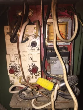

I’m sorry about the poor description of my furnace . I had this furnace installed 15 years ago. It’s a wf200 with a oil furnace as well, I had to change out my kytec pipes with pex pipes. I noticed one zone had two supply lines hooked up so I fixed that now I still can’t get any heat in this zone. The wood furnace drafter Is closed down and the oil furnace is not cutting in , the Thermostat is still calling for heat , when I turn one control in the Aquastat box on the oil furnace the circulator pump cuts in , I’m so discussed with this furnace I hade a few people look at it but it don’t seem to work right

We can't really do much from here without very accurate schematics/diagrams of all the piping, and wiring, and components. A full set of pictures of all the system might help a bit.
I also have a New yorker wf100 wood boiler added to my new yorker oil burner. Mind works perfect except it isnt very wood efficient compared to the the wood gasers. You sane you have 2 supply lines to one zone? Thats would be correct one is the dump zone from the wood boiler going to to the biggest loop in your home. This system is designed that all the heat comes from the oil boiler. When burner wood the second circulator keeps hot water to the oil boiler and therefore the oil don t cut in. there is another link from this same forum. https://www.hearth.com/talk/threads/new-yorker-100-pros-and-cons.63263/ I have uploaded the installation manual and wiring diagram to this boiler!
