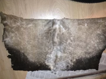

How you liking your 2700? Took a while for me to get used to it, but I still can't get long burns or anything over say 6 hours or so. Still fearful of packing it as most people say to do and the air flow does not seem to damper down very much. Also, does this look proper for two years on the ceramic blanket?
Been out of town and haven't had a chance to check in until now.
I like my 2700 but I use it maybe five to ten times per winter because the Isle Royale carries the load for the house unless it's really, really cold (negative
double digits). I am far from the expert on this unit. Some others could weigh in on the hearth sub-forum. My blanket still looks pretty new.
My flue is pretty short upstairs, so I haven't had much trouble controlling the burn. I do generally pack it when I use it, as the firebox is pretty small.
I do get overnight burns with oak or hickory if I load up before going to bed.
