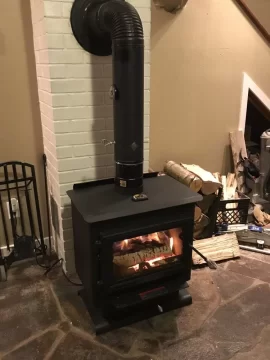

Ok so I checked the tubes and they were clean and clear.
Then I brought my air compressor inside and this is where things got screwy!
First I blew out the little time holes behind the front legs and air came out of what I believe is called the doghouse. At first no air was coming out but then it started to flow almost like it was clogged.
Next I blew air into the square hole in the back near the blower and air came out of the top of the stove like the tube area. Fine.
Then I blew air through the round hole where the OAK would go. Nothing. No air anywhere. Played with the slide and no air?!?!?
It’s an Englander 30. What am I missing? Where should the primary air be coming into the stove at?
