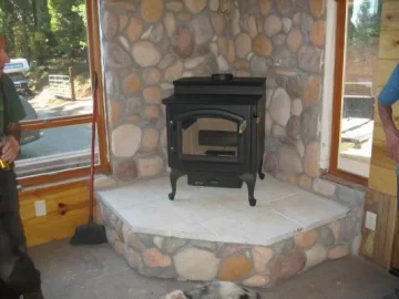

I did this with cultured stone in less then 3 days myself (with a bit of help ) and had not done alot of masonry before. Id say that quote is way high.

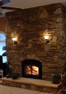

my hearth took an experienced mason and his assistant 90 hrs to complete. Luckily I paid by the job not the hour. Measures 8.5' wide, 11' tall, and 2.5' deep.
