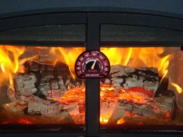

When the outside temp is kind of warm (50F+) I can't really back my (Lopi declaration) air control off more than about 1/2 way, unless I really have it roaring first.
This is where I keep my thermometer, it seems to give a closer reading than on the grates above the door like the manual says.

Hi Bubbavh,
Just a quick note regarding thermometer placement. If you take the grille off, you can mount the thermometer directly to the stove - behind the grille. You can see it through the louvers in the grille, it's permanent and it's not as noticeable as when placed on the door. Mine seems to work out fairly well there. Thought you might want to give it a shot!

Thanks for the info...I tried just about everywhere too (that thermometer is ugly) but the temp you will get isn't very accurate because the fan will blow on it and cool it off.

Shot it with his laser thermometer and between the doors was the sweet spot!

By the way, I got a laser-sighted IR thermometer which I shoot between the grills to the top of the firebox for what I believe is an accurate read.
