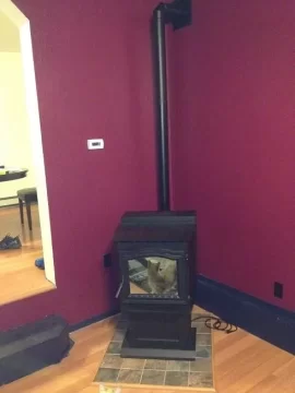

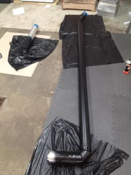

I used Stove Bright to paint my, seen it recomended many times. EDIT: My dealer carried the Stove Bright.
Quick sand, and used a lighter to clean off label adhesive.
If you can get black venting easily, do it. If you can't, painting it is very easy.
You can save $$ by buying the plain galvanized pipe and painting it yourself. Only items needed are a couple qts. of white vinegar and a couple cans of RustOLeum Satin black stove hi heat paint (Walmart for both items). The pipe needs to be washed down with the vinegar and a rag (pickling), rinsed clean and dried so the paint will stick.
