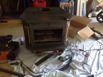

Hey all,

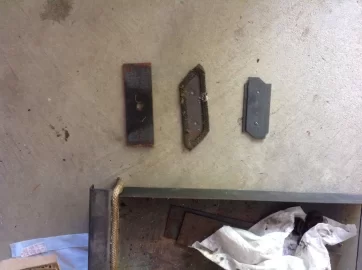

I am putting together a used buck model 91 insert. There were 3 small plates with some shims thrown in the ash pan. I can't figure out where these would go on my stove. One has a gasket so I am very concerned that it is important. The other is a similar size with two broken off screws in it. The third looks more like a thick shim, slightly bent with a hole through the center. Please take a look and let me know your thoughts. Thanks!

I missed this post the first time around. Those parts don't look like anything I have seen on my Buck. I would look underneath the ash lip at the slider rods and plates that control the air wash and shotgun air.
