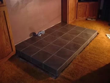

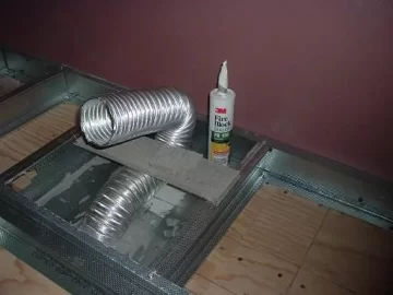

I used 3 inch flex dryer vent. Flexy for ease of installation and routing. I had a few bends that the prefabbed elbows couldn't handle. My HS uses a 3" nipple for an excellent fit inside the 3" vent pipe. I went into the vented crawlspace beneath the stove so the air should always be about 50 degrees. No frost or condensation has been seen at all in my climate.
It doesn't get at all, always cold to the touch, and if by some chance it ever did get hot enough to fail it would either collapse on iteself killing the fire or it would open up a leak and use room air. No real risk either way. Mine even was flowing air due to the chimney effect before I even put the stove on it. I had to zip tie a bag on to plug it.
Supercharger!!
