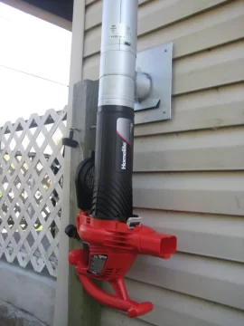

this came from home depot and is a perfect fit for 4' pipe.. homelite brand i think.
