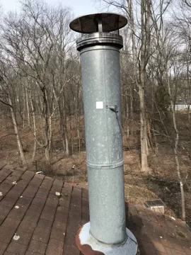

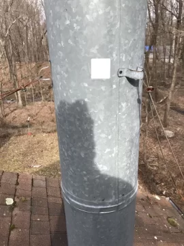

Hey all,
I'm hoping someone can help me identify the manufacturer of this galvanized (?) chimney. Is it Class A, capable of venting a wood stove? It's 8" inner diameter, currently venting a gas log set. It's only 5' tall. Ideally, I'd like to attach another 5' section and be on my way, but I know these things are never that simple!

Can't help you with the chimney type, but you might want to consider installing flashing while you're up there.

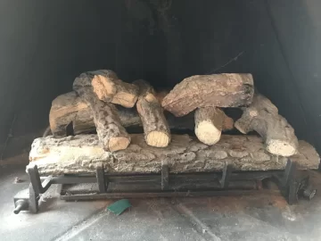

Is it insulated or air cooled? What are the gas logs is that you plan on venting through with a wood stove?

I should have been more clear. There are gas logs there currently. I want to remove them and install a wood stove.
I *think* it's air cooled. I'll have to go back up there and check after the snow melts.

Yes I got that but what is the gas log set in? If it is just air cooled with no insulation it should not be used for a wood stove

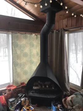

The gas logs are set in a free standing stove that connects to 8" single wall.
Ok that is a freestanding fireplace from the 70s. The chimney is probably not suitable for a wood stove.
I was afraid that might be the answer. I guess I'll have to budget for all new pipe.
