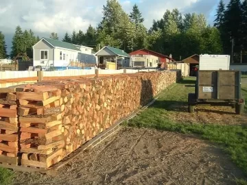

Pallets. They are also a stable base and can be cut to fit. I get at least two years out of pre-aged pallets from a lumber yard.
I like wood fences but I like two rows of depth for stability which uses up most of the normal pallet width. Dispose of the dead ones in the campfire or many folks burn them in the stove. They'll dry out.
  • [Hearth.com] What do you stack your wood on???

GOOD LORD MAN...it appears there is one piece of wood out of order on the far end! ;-P THAT is a nice stack job!.
