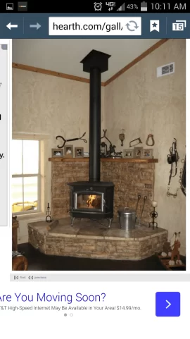

I'm ok if the furnace has to run some but would like to limit it. I have used about 350 gallons of propane so far. I'm attaching a photo of what I would like it to look like. I have a budget of about $4500 including everything. Wood supply should be at 3 cords by the end of February.

I have a Napoleon 1100 waiting for me to finish the hearth so that I can place it where I want it. With the typical discounts from retail it cost several hundred dollars less than the list price and was delivered right to my door for about $1500. My chimney cost me under $1000 and the hearth area costs whatever you are willing to pay for fancy brick or more basic ceramic tile like I am using for a few hundred. Review the installation details before you buy. Some stoves only need a spark guard type hearth to protect against glowing embers while others require significant insulation from all combustibles. The picture you showed has a stove quite close to an outside wall so make sure the stove you choose has small clearance requirements to combustibles and plan up front to use double wall stove pipe. Bricking the surrounding area just means you need more room because any studs on the back of those bricks are considered unprotected by the brick. I know that's weird but it is the way it is. To get credit for shielding you need to have an air space behind the brick at least an inch wide with an opening top and bottom for air to flow in the space. Look carefully at the options for those stoves. Some can have an outside air kit attached and some are just not made for that. You will at least want the option if you have a tight house. Grisu seems to have a handle on size, which I do not, so he has given you that perspective. I am totally new to wood stoves but have done enough research to know about how to buy one, at least for me.
