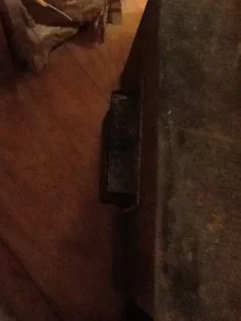

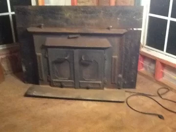

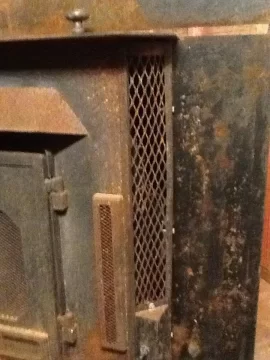

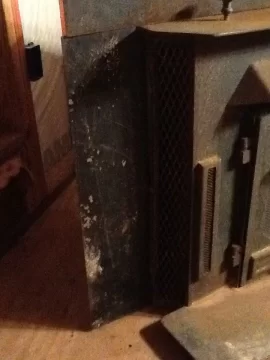

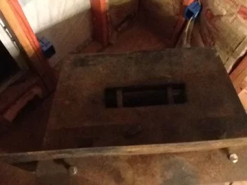

I don't have an existing fireplace and I want to install the one in the picture.I cannot seem to find much info on installing also any ideas what kind of fireplace this is there is no tags or identification marks.thanks

Looks like a old Buck. That insert can not be installed in anything but a full masonry fireplace. If you have no fireplace then it makes no sense to try and install it. Sell it and consider installing a modern freestanding wood stove instead.
By the looks of the outlet this is a "slammer" right?
Slammer is the type of install not the stove. But yes these old bucks origonally were mesnt to be installed that way with no connection to the flue. But they can have a liner fitted to them.

I want this in my house.being a fitter welder all my life fabricating a transition from that rectangular hole to a piece of stove pipe is a walk in the park and I can solid weld it to the buck itself it's all plate steel no cast.The damper valve is mounted inside the fireplace at that rectangular hole.

Ok a slammer install is an insert just slid into a firebox with no connection to the flue. In order to use that insert you would need to build a code compliant firebox. That means a footer and foundation under it. Cut the floor out and pour a slab. Then build 8" thick solid masonry walls surrounding it. You will have to either build all the way up with masonry or transition to class a chimney above the smoke chamber area. You will need a boot for the top of your stove and a liner to connect that to the class a pr to run up and out the top.
