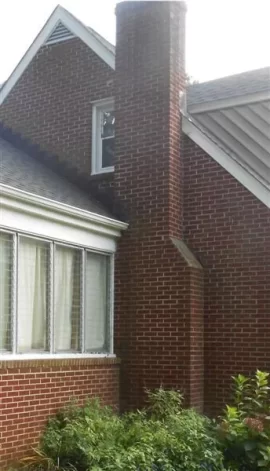

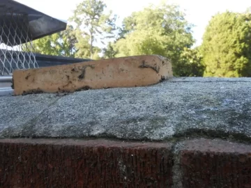

Hello,
I am looking to install an insulated flexible liner inside of my existing chimney but I first need to know how to extend my chimney. In order to get it 2' above my peak (which is within 10' of the chimney) I need to extend the chimney by 54". Can someone give me some ideas on the best way to do this?

It's not quite 54" but could you get a 6" rigid clay top plate and join a 48" length of rigid 6" to go from just below the plate up to the cap?

I ended up doing just that but with a flat top plate and modifying a brace kit to stabilize it. Now I need to figure out how to go from the liner to the stove but that is for another thread.
