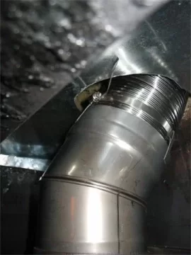

I used a stainless steel fixed elbow with mine. A bead of furnace cement in the flue collar and inside the end the liner clamps into. When I have to move it forward for blower maintenance I will disconnect the liner from the elbow to pull it up.

I wish I had enough room for the elbow but I don't :(. The elbow would at best gain me an inch, probably even less. I just don't have that kind of room between the top of the stove and the bottom of the steel box. As it is an offset box would be tight. Still think a guy could weld one up. I may try that if i can wrestle up the steel.
